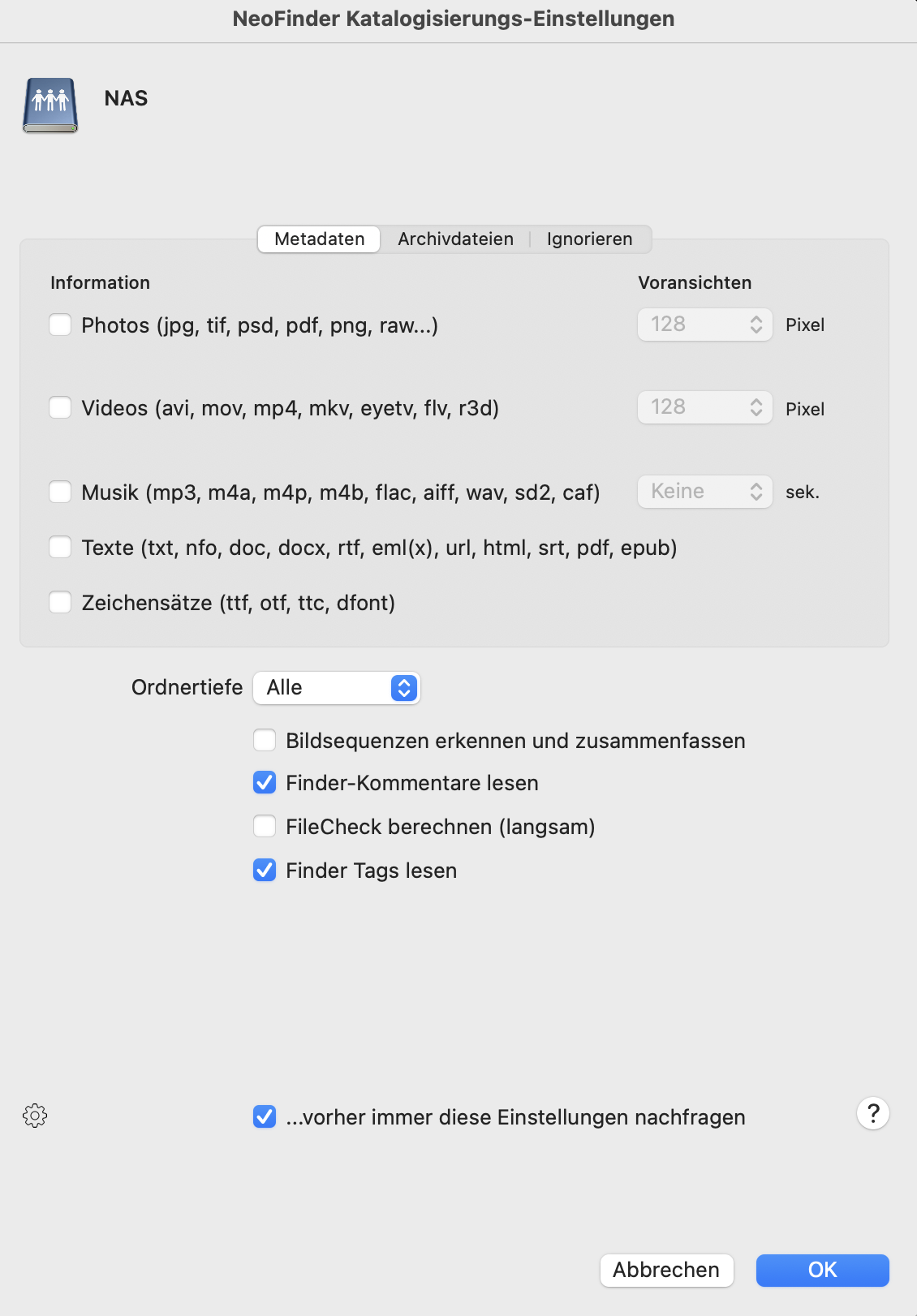

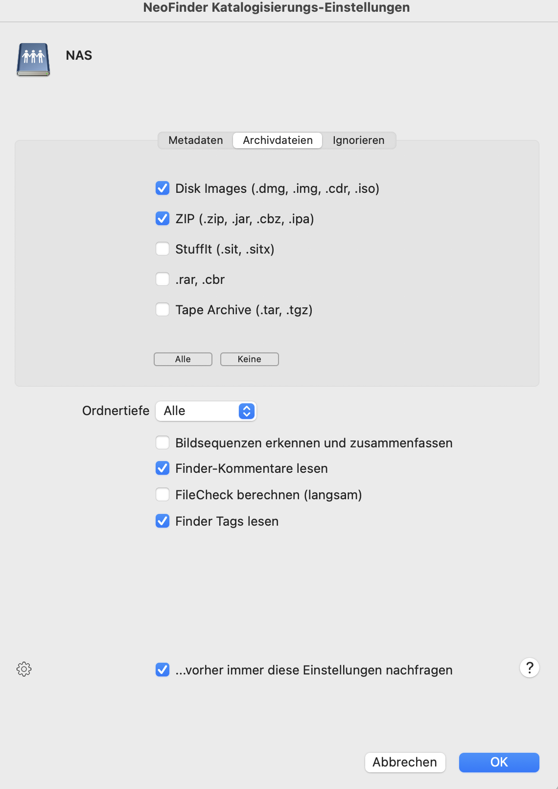

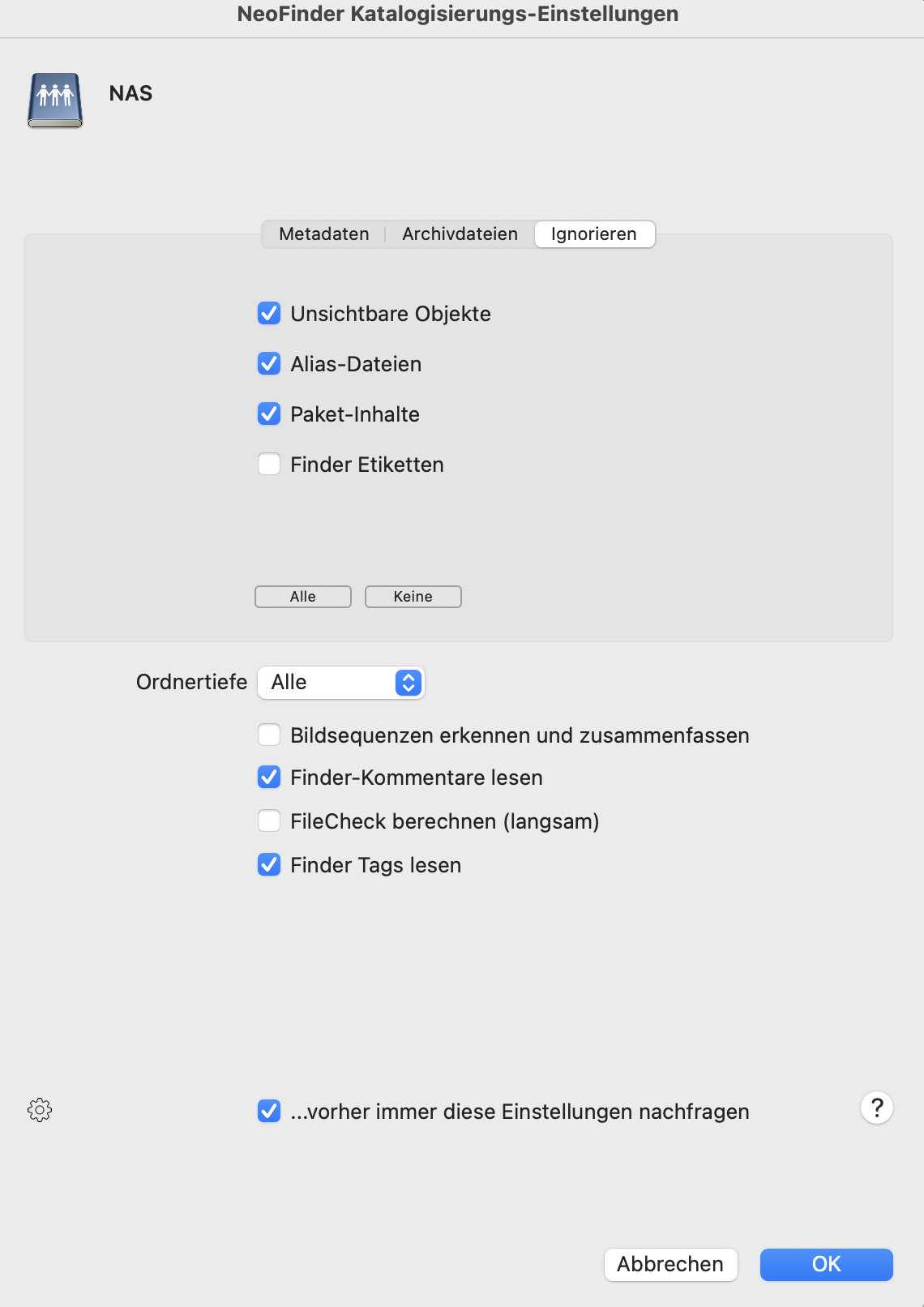

I have uploaded my settings regarding the updating (so no recreating of preview files are happening).

as the NeoFinder Users Guide explains, reading Finder Comments and Finder Tags is very slow on macOS, due to the rather lame (sic!) SMB client from Apple:
https://www.cdfinder.de/guide/11/11.1/f ... oging.html
Also, instead of cataloging an entire huge volume, break the cataloging process up by cataloging separate top level folders separately, which will then later allow you to update only those that you know have changed.
