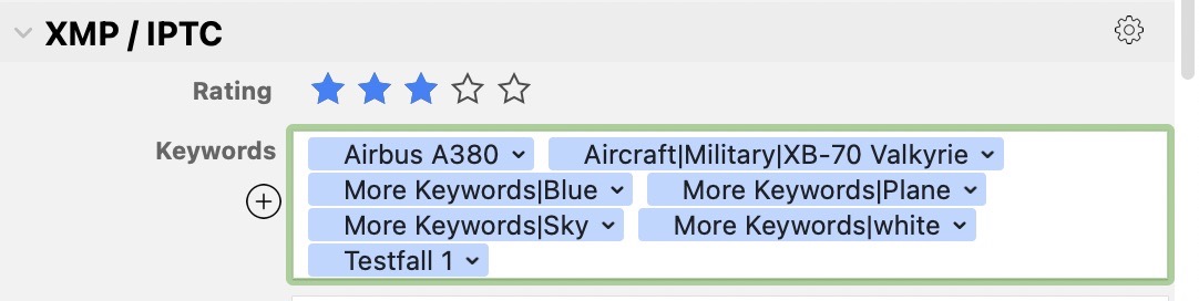

A client recently told us that she had received a couple of thousand files from a contractor, and each of these files contained a lot of XMP keywords. That was OK, but someone had placed hundreds of these keywords in an hierarchical group named "More Keywords", so the result was confusing, and differed from the regular keywords normally used.
unwanted hGroup.jpg (57.71 KiB) Viewed 200334 times
The client asked us if there was a way to get rid of these.

I made my hierarchies really deep early on and now it just looks a mess, and I have abandoned using hierarchical keywords now, but have lots of historical images with a long hierarchy.
I used to use topics as one of the hierarchies so it looks a mess.
