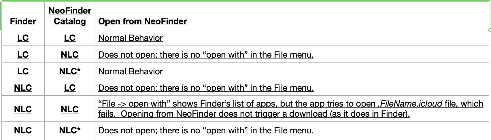

Plus, define modified NLC* state for NeoFinder: Start with NeoFinder in NLC (so Path/.FileName.icloud is cataloged) and then in the information pain change the Name field from .FileName.icloud to FileName with “Also rename on volume” checked. The NeoFinder user’s guide (section 8.6) says, “NeoFinder will also rename the original item on the disk” when this box is checked." That’s not quite what happens. Nothing changes in Finder because it always displays FileName (with or without the iCloud indicator). But Linux “ls -alh” shows that .FileName.icloud has not been renamed (which is probably not a good thing). What the “Also rename on volume” checkbox does for us is change the NeoFinder Path in the information panel to Path/FileName - which is what we want. Note that NLC* is fragile; a catalog update will revert to LC or NLC.
So now we have six Finder/NeoFinder state pairs to test. My results are presented here:
Screenshot 2023-07-07 at 5.43.16 PM.png (171.22 KiB) Viewed 3528 times
In particular, the third row shows that if NeoFinder maintains the proper Name and Path, it operates normally even if the information record was created with Finder in LC. We need a solution for when the Finder is in NLC.
