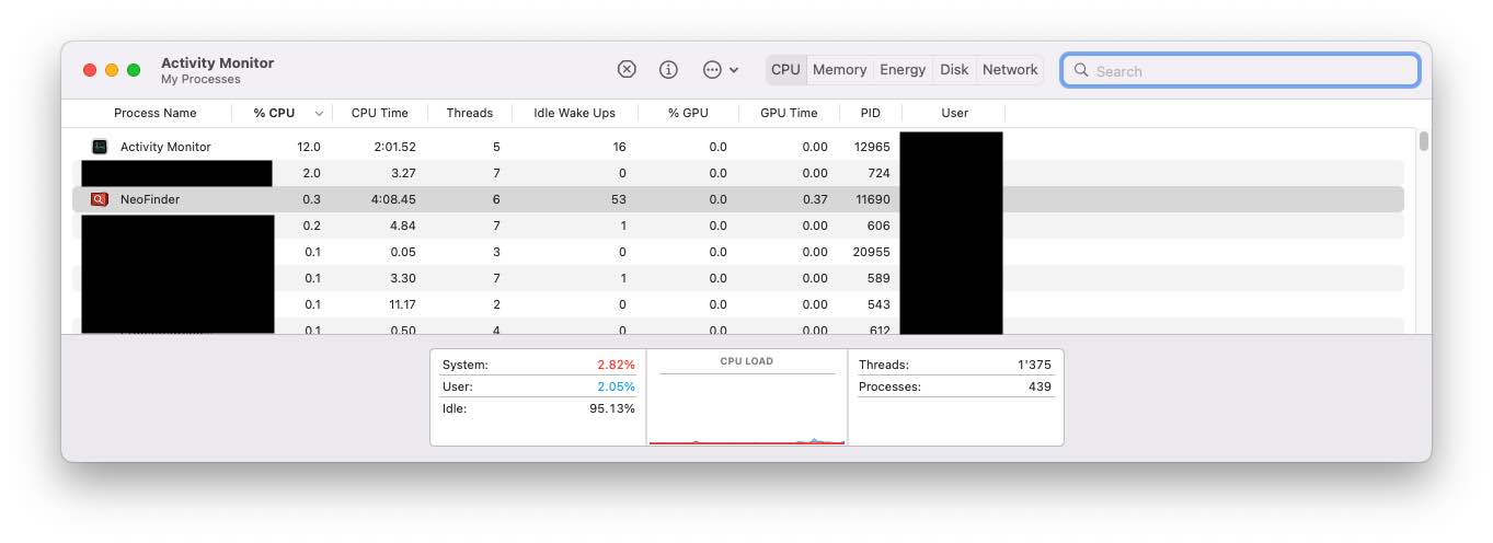

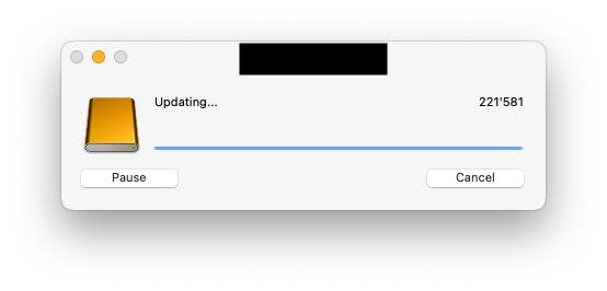

  • at some point in time, the NeoFinder scanning progress indicator will slow down massively. You can see increments of like 30-50 files with a noticeable waiting time between updates of the number of scanned files.
  • during this extremely slow progress, it can also be observed in the Activity Monitor the NeoFinder process drops down to a very low CPU activity and remains there for most of the time. Whereas when I scanned HFS volumes I did not observe these drops, but NeoFinder was working "good", and did not "stall" - as it seems to give the impression with NTFS volumes.

The NTFS driver in macOS is indeed extremely slow.
Apple has never fixed that, althought we have reported the problem multiple times in the past.
Same for the ExFAT driver in macOS, unfortunately.
As the NeoFinder Users Guide shows, there are some ways to speed up cataloging a bit:
https://www.cdfinder.de/guide/24/neofin ... prefs.html
Topic: "Catalog of FileType/Creator data"
And last, this forum has some tips as well:
viewtopic.php?t=10
You may also have better speed with third-party NTFS drivers for macOS.
