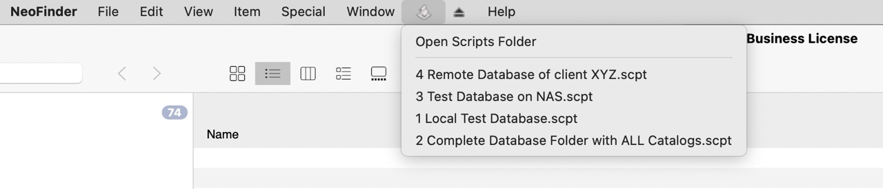

Q: Is it possible to use multiple different database folders in #NeoFinder and quickly switch between them?
A. Yes, with a little help of the powerful #AppleScript #Automation, that is possible and really comfortable.
The NeoFinder Users Guide has all the details and examples on how this works.
https://www.cdfinder.de/guide/9/9.4/neo ... prefs.html
multiple database folders.jpg (49.3 KiB) Viewed 3017 times
